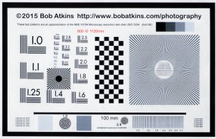

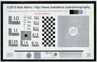

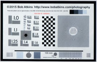

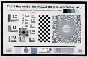

To show you how good the RF 100-500mm + RF 2x is, here are my charts comparing it with the RF 800 f/11 and the 400mm DO II + 2xTC at 20m. These charts are only 14cmx9cm at 20m away and just 600 dpi laser prints on paper, not proper high resolution ones so they are pretty rough but they are good enough to tell you whats going on.
309A5483-DxO__Chart_20m_1000mm_centre_marked.jpg309A7403-DxO__Chart_20m_DO_800mm_centre_marked.jpg309A5382-DxO__Chart_20m_800mm_centre_marked.jpg
View attachment 201405View attachment 201406View attachment 201407
Thanks for this comparison. I had considered the EF 400mm DO II + extenders a while back but decided to wait. Then the RF 800 appeared and it seemed like something I should check out first. I've quite happy with the choice and these images suggest it was a good decision. Did you consider comparing the RF 100-500 at 1000mm to the RF 800 at 1120mm?
I'm also quite happy with the RF 100-400 for the weight difference from the EF 100-400 on extended carries.
Were the charts shot with an R5 or R6? If with an R5, I am very impressed with the RF800 f/11. It would be interesting to see how an EF 800 f/5.6 would look in that comparison. Other reports I have seen suggest that the RF800 is best at distance, but I have not seen any info as to what distance is required to get the best performance. Given the price, I would expect the RF 100-500 to be quite good, but it appears to be better than many expected given that the aperture was narrower than the unicorn they dreamed of. Certainly, the size/weight is favorable. I have just not been too tempted given that the EF100-400 II that I already have works so well and the EF800 is quite good for the really long stuff. I have been tempted by the RF800, though, thanks to its low cost and light weight.
Sorry, I should have said R5. The EF 100-400 II is still a superb lens. I got the RF 800 f/11 for a bit of fun - WEX had one used 10+ at clearly a mistakenly low price and I snapped it up. However, now I have bought my wife an R6, we can travel, if covid ever permits, with her having the RF 100-400mm for hiking, and the 800mm when shooting from a vehicle, and I the 100-500mm + TCs. When you get down to f/11, the R5 has only about 20% more resolution than the R6,and the 800 on the R6 outresolves the 100-500mm on the R5 and gives very nice images.
