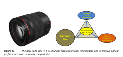

I reached the same conclusion for the 24-105 after comparing the MTF charts. It is somewhat unfortunate that the resolving power isn't a full step up from the EF mk II version, but it seems that the intention was to reduce size and weight. If not looking for specialty lenses, these benefits will likely be what most people starting out in FF mirrorless photography will appreciate the most.

Interesting, thanks for sharing.
I was hoping the RF 24-105 would (also) be optically superior to its EF brother, but clearly the optical potential touted didn’t quite make it to that one. Still, it might be good enough for travel use if the size/weight is enough of a reduction, we’ll see.
On the other hand, the 50 1.2 looks awesome. Can’t wait to see actual images from it.

Be careful when looking at and comparing MTF charts. There was a discussion on the new 600 f/4 that the new charts may be using a different standard. The new 600 III MTF looks bad when compared to the MTF charts released with the 600 II. The RF 24-105 has the new "Look", it only has 4 lines instead of the 8 used in the old charts for the EF 24-105. Not sure what it all means or what's changed. Canon Japan had the new charts for both the 600 II and III and they showed an improvement in the corners for the 600 III.

Going by pages 24-26 in the "white paper", it appears the "new" charts are used in all of the comparisons. By Canon's own words, there are aspects where the RF version is worse than the EF one (and likewise, others where the RF is a little better). We'll have to wait for the tests to see how that translates to actual images, but personally, not too encouraging TBH.
