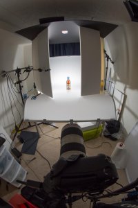

@victorwol: why have u got a black card on top of the bottle picture setup?
