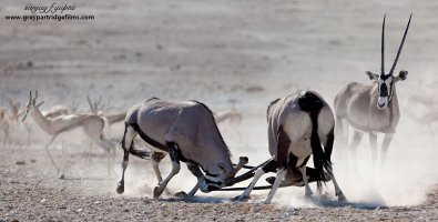

Attached is a photo shot at 1/1250

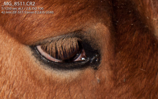

This is what I get with a Canon 50D and 17-55 with IS turned on and fast shutter speeds.
(Click the crop to get 1:1 res)
I have always left IS on when handheld so I can't compare it to non-IS pictures unfortunately, but I have always found the lens sharp and never felt a lack of sharpness
edit: I uploaded the crop as a .png to avoid compression, but I see that imgur has converted the file to a jpeg.
Therefore, I have included the png as an attatchment to this post.
