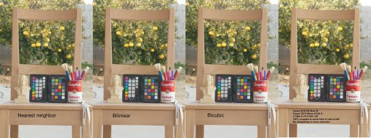

dtaylor said:
I can't help but laugh at your asinine behavior. You really do believe that you know more then all the people pointing out the flaws, don't you?
There is no polite way to tell somebody, such as you, the level of ignorance and / or lack of intelligence displayed by repeatedly claiming that the Canon 135mm SF is sharper than the Canon TS-E 24mm II. I'm sorry, but your repeated insistence that my test is invalid because I used the sharpest lens on the market for the one, one of the softest lenses available for the other, and that said lens difference skewed the results, when the image made with the softer lens came out sharper...well, there really aren't any polite words to describe your position.
Scaling in either direction introduces a variable you can't compensate for. And in either direction final quality and sharpness depends on the algorithm and settings used. Go ahead and try scaling in PS with all the various choices.
That you've been on this kick clearly demonstrates that you've never done such an experiment, yourself.
Attached you'll find the results. The only significant difference, as one would expect, is the amplification of image noise in the nearest neighbor sample.
Indeed, your ignorance of the subject of scaling and sharpness is especially apparent here; anybody with experience in the matter knows that downsampling softens images, and that you need to apply a bit of sharpening to recover a bit of acutance. As with the lenses, you're arguing that something that skewed the results in favor of the small format somehow prejudiced the results against it.
Perspective has nothing to do with sharpness at the plane of focus.
Perspective has everything to do with photography.
Just try telling a real photographer that she's got to shoot her small format camera from a different position to maximize its sharpness compared with a larger format camera -- which is exactly what you're arguing for with your royally messed-up joke of an experimental protocol.
Cheers,
b&
