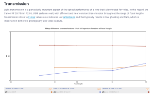

You have to go into the DxO site and you will find it gives the Sigma at different lengths. I couldn't find the 150-600mm, At 500mm for the 150-500mm, the T-stop is 7.3 (click on transmission) in:
They have the Tamron 150-600mm, and that is T= 7.5 at 600mm.
OK, that is seriously helpful. Well played Sir. Using the interim data on the zoom range I can build a decent comparison across lenses even if zoom ranges differ, (if ultimately needed). You've saved me days on behalf of my mates. Thank you.
