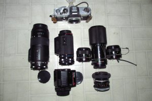

Dear Friends
I am Canon Fan/ user since 1954, My First Canon Camera = FT-QL, and until 1999, I have 6 more Canon Camera Bodies, And 7 Canon FD Lenses.
The Question that = The FD Lenses are worth to use with my EOS system with the Cheap Adapter( $ 35 US Dollars ) ?.
Yes, I have 24 Canon/ Sigma/ Tamron Lenses ( include 8 Canon " L " Lenses).
Thanks you, Sir.
Surapon

Thank you for your great Comments. No, After I took the Photos of theses Old FD. Lenses, And I look in more details of each Lens. No - Not have a great Quality as my present " L " Lens, Only one that might be Good = FD 50mm 1.4, That Glass still clear and beautiful after 35 years.
But I already have Sigma 50 mm. F/ 1.4 for bigger glass Lens.

If the picture you posted are the FD lenses you have, then I'd answer no. If you have the FD longer L lenses,
then the answer may be "yes". The macro suggestions are valid, but it's tough to beat the 100 EF macro.
Thank you, Sir Dear Dickgrafixstop.
I agree with you, All the Lens that I Have " FD " lens = Cheap and soso quality any ways, = When I was youn = No money, but have alot of Free Time.
3 years ago, Before I buy Canon EF 600 mm. I look in to Canon FD 600 mm . too, So cheap and great Lens, But I make decision to buy the New EF 600 mm for my Birds Photography.
Thanks you, Sir.
Surapon

Now, I already make my mind, Just use the old FD lens with my 5 Old cameras, And Just use My EF lens with modern EOS Cameras.
Thanks again.
Surapon
