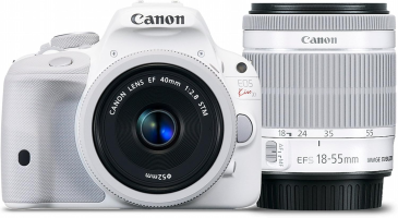

I think Japanese domestic market had some special-color models. Here's the EOS Kiss X7(White) Double Zoom Kit 2 EF-S18-55mm F3.5-5.6 IS STM(White) EF40mm F2.8 STM(White) Included KISSX7WH-WLK2.

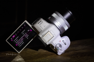

With its black sibling but only the one lens:

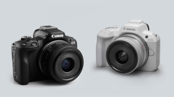

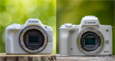

White Canon R50 and M50:
Black R50 which black lens, white R50 with silver lens:

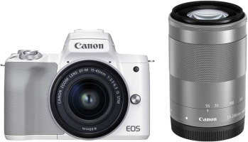

Kiss M2 in white, silver lens:

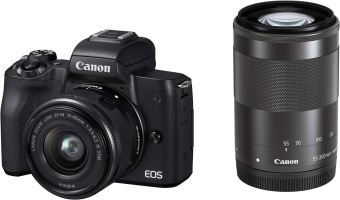

Black, black lens:
