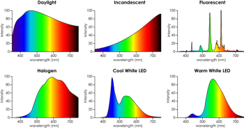

IglooEater
EOS R
Nov 15, 2014
904
Private explained it pretty well. The light spectrum of you're screen will basically be three spikes of colour- one at blue, one at green, one at red. That will cause tonal variations when compared to other light sources that appear the same colour of white. They will also differ between screens depending on the exact tone of r g and b, and their respective intensities.
A cute inforgraphic pulled from RedUser, the whole discussion here: http://www.reduser.net/forum/showthread.php?148460-Dragon-Sensor-Tungsten-or-HMI-(Native-WB-) (discussion has more to do with CMOS than light. This graph will definitely show you why skin tones always look funny under flourescent light)
Thanks for this - helps me too.
