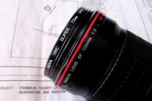

B+ W have many Level of UV ( 72 MM--Example)--Start from the Cheapest one = UV Haze SC 010 , 72 mm = $ 34 US Dollars ( At B&H), UV filter-Slim = $60.50, UV Multicoated = $ 71.75, UV - 415 ( 2B) = $ 200, XS PRO UV # 010M = $ 95.95, and XS-PRO UV MRC NANO MC # 010 M = $ 70.99------------
My question is, Should I pick the Highest Cost one ?----IF NOT, Which one should I pick---Yes, When I buy my new 135 L from local Camera shop, they give me free Hoya HMC SUPER 72 mm. UV ( ) ) Made in Japan.
As your IDEA, Sir. Will I go to buy B=W Filter as your Recommend--Or just use the Freeby Hoya Filter ?
Thank you, Sir for your Advice.
Surapon
Yes, The real cost of Hoya 72mm UV (Ultra Violet) Super HMC Multi Coated Glass Filter= $ 70 us. Dollars at Amazon --Free Shipping.
