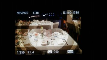

I'm getting peculiar issues with the 1DXII with Sigma 35 1.4 Art Lenses.
We used two 1DX II Bodies for a wedding last weekend and came across this weird problem
We get concentric rings around the photos see attached.
originally i thought it was a setting in my camera.... and i couldnt figure it out... even after i reset the camera...
and then it clicked and i realised i was only getting concentric circles when using the Sigma 35 Art 1.4
I then swapped that lens onto another 1DX II body and i got the identical problem also with that body so it seems to be its an issue with the firmware ..
interesting note
- when i downloaded all the files onto our servers and i did a filter for the 35mm 1.4 Art NONE of the photos showed the rings ON the raw images.
- NOT all photos taken with the sigma 35mm showed the Concentric rings on the Body LCD Screen. Only some exhibited this behaviour
- I took OUR the CF card and stuck it in my 5d3 body during the evening of the wedding coverage and noticed when i played back the image ON the 5d3 IT ALSO showed the concentric rings on the LCD Panel ???
- I stuck a 24mm Sigma 1.4 Art on the camera and didnt have issues or the concentric rings
- i could however consistently get the issue with the 2 1DX2 Bodies
Anyone else experienced this ?
over all the camera is a great camera... but this weird concentric circle issue is bizzare

I am having the same issue as well on my Sigma art 35mm 1.4 and it is on all the pics I am taking with it.
Please let me know if anybody has a fix for it.
I think it was already mentioned it's the peripheral illumination setting. Just disable that and you're good.
tpatana said:
Thanks,
I just saw that on the other topic. That makes me a happy new owner.
