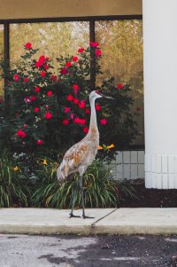

Hey guys, i'm new here. I have an 80D and recently purchased an M100 as a throw-around camera. I took a picture the other day of a sand crane and it looked very out of focus. The camera was in single point, one shot, autofocus. Any ideas what was wrong? Never had an issue with focus in a well lit environment like that.

Please provide shooting information, including focal point
For some reason Lightroom didn’t pick up the EXIF data. If I recall it was at 45mm, f/6.3, and I’m not certain of shutter speed. I was shooting this in Av.

The environment doesn't seem to be "well lit". Which ISO was it?

Can you provide a link to the original (in-camera) image?
It also looks like the focus is on foliage behind the bird's head, but that could be an artifact of noise reduction.

Hard to tell. Maybe some back focus? Need more information to know for sure...
Even when focused, the 15-45 is a mediocre lens at best, though, don’t expect miracles with it.

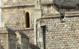

15-45 is not a bad lens see attached
this is at pixel level taken with M50 19mm, f9, 1/250

My 15-45mm is as sharp as my 11-22mm and 18-150mm where they overlap, and the MTFs from photozone and charts from TDP back that up. The 15-45mm is a respectable little lens.
I guess it's possible that I have an underperforming copy(!) - but I stand by what I said - I'm not satisfied with the results out of it. The center is ok, but the corners are horrific...My 18-150 is better (albeit not by very much) and my 11-22 is a LOT better.
It's served its purpose more or less, I'll probably let it go at some point.
