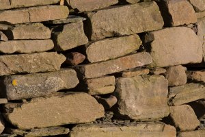

Hi,
Thanks for the further comments. I'll try weights cos it is a metal tripod (Benro) with an Induro BHD 1 ball head.
I am getting strange results - attached two pics of a stone wall and both are pretty sharp, one using the extender and the other the basic lens. Cropped the 400mm pic to give the same field of view as the 800. Both shot at 1/25sec!!! and no camera shake and my previous moon pics were 1/800sec for the 800mm and 1/250sec for 400mm yet the fast shutter speed for the moon gives a blurred image. So not sure the source of my problem is vibration. Really confused why I can't get a decent focus at infinity (ie the moon) when these two pics indicate the combo is not bad.

I don't think it's motion blur - just softness from the lens+extender combo. It matches Brian's results from The Digital Picture. The 2x isn't ideal for most lenses and it looks like the new 100-400 is (sadly) no exception.

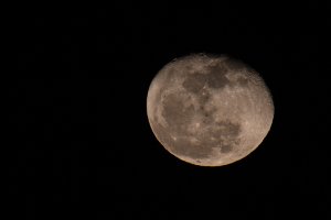

I just received my 100-400II along with the 2xIII today. Here's an 800mm moon shot that I took this evening, for additional comparison. This is probably about 70% crop or so, and I did play with it a bit in Lightroom just to see what it was capable of. This was from an aluminum tripod, 10 second countdown, 1/13s exposure, f/14. I manually focused it with 10x live view, keeping IS on until I was ready to take the shot. I think it came out pretty well and so far I'm pretty impressed with the few shots I'm seeing using the 2x. I'm hoping to get out this weekend and really try it out with some wildlife.
