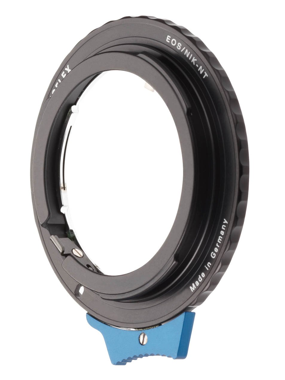

This is what Novoflex [a highly regarded german precision mechanics company, not some cheapo Chinese copyshop] can do with 2.5mm FFD difference. Nikon F to EF mount. Even including manual aperture control (=for Nikon lenses without aperture ring). Notice how thick that flange is? 0.5mm could still be shaved off, i guess.

Do you realize the difference between a lens protruding into a wider camera mount and a lens trying to protrude into a narrower camera mount?

aha! yes! Now I got you. (y)
Overlooked the difference in diameter, just focused on FFD delta. 54mm throat-width lens onto a 47mm inner-width mount with only 2mm FFD delta is ... hmmmpf ... :oops:
So, I stand corrected: RF to EF-M adapter "not likely". ;-)
