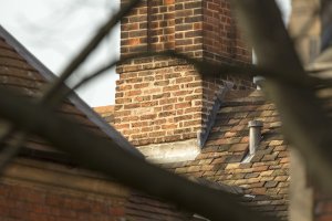

I did another comparison of the Tamron 150-600mm @600mm versus the Canon 300 f/2.8 II + 2xTC III on a 5DIII. A Tudor chimney overlooking my garden has very nice detail and shading in the bricks and mortar. In this collage of 100% crops of 800x700, which are testing the resolution at the limits, you can see that the Canon does have the edge, but the Tamron does very well.
I have made a personal decision to never take or comment on "brick wall of shame" crops. Maybe stating that goes against my conviction but I hold fast.
As someone who’s currently building up a collection of kit, I’d like to thank Alan F for his brick wall shots. I can clearly see that the L glass plus a 2xTC offers better IQ than a third party, 1/3-of-the-price lens.

candc said:
That sir is not any old brick wall. That is a genuine Tudor base of a chimney of Trinity College Cambridge, the Home of Sir Isaac Newton, the inventor of, among many other great things, gravity, the prism, the mirror lens telescope, and the founder of modern optics, without which we would not have "glass". Any more comments like that and I will challenge you to a duel of calculus at dawn.
Here is the full frame, showing the glorious base with the Victorian addition or restoration above.

Yes. The Tamron is at its best between 200 and 400mm, and really superb at 300mm. It is as good as a good copy of the 100-400 at 400mm, and much better in the corners - it fares well against the 400 f/5.6L over the whole frame. The 400 L is very good with a 1.4xTC, the 300L f/4 is not as good. The 100-400 has crippled AF with a TC, and is f/8. The Tamron has rendered those older lenses obsolete. I am afraid you have to spend 5x more on the 300mm f/2.8 to beat it.

considering the stature and eminence of the "brick chimney of glory" i reckon its okay to say that the crops all look really good, the ones from the canon combo are a bit better but you have to look close at 100% crops to see the difference. i don't think you would see a difference at normal viewing size. to me the tamron is like the 70-300l in that it will give you great result across its range in a relatively compact lightweight package. it might not have quite the sharpness or max aperture of the big canon primes but its really good, especially considering the cost, weight, size, and its a zoom
