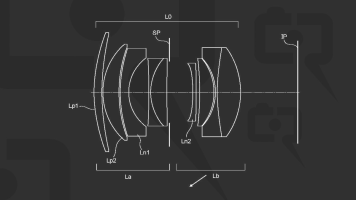

The graphics look pretty much like classical Double-Gauss design.
So I wouldn't expect magical resolution numbers from them.
But we know the magic such lenses might have...
I hope that the AF motor is fast enough... :unsure:
And, @Richard CR, don't you think that 48.6 mm is closer to 50 mm than to 45?
Could also be named 50/1.2, couldn't it? (apart from the rumored name)
If I'm not mistaken, the RF 50mm f/1.8 STM is a 48.5mm as well
By the way, could these be plastic moulded elements? Those would certainly be a lot lighter
Indeed, it does. Reminiscent of the EF 50/1.2 or the 50/1.4. I would imagine performance closer to the 1.2, but who knows. A very lightweight 50/1.2, even if not optically stellar like the current RF 50/1.2L, would be a welcome lens to many. And there is 'some' magic in that slightly less than perfect old 50/1.2. It has character.
It's a modern short backfocus double gauss derived design just as I anticipated in the other thread. Checked the patent and looks like they are using some really high abbe number glass. Another improvement is it's rear group focus instead of full group focus, so a lot less moving mass.
As for abberation correction with this few elements, they definitely would have to make tradeoffs. Just as I predicted, it lean toward a little residual SA, which can be desirable for bokeh and oof background. Distortion is sacrificed, CA is lower than the EF but still present. Overall I think they made good choices

This looks considerably more complex than a double Gauss design. (Gauss was a person, thus the capitalization of a proper noun. Double is not.)
Here's the EF 50mm f/1.8 STM with a classic double Gauss design:
For more about what makes a lens a double Gauss, please see Roger Cicala's excellent article:
Why are modern 50mm lenses so damned complicated?
This looks considerably more complex than a double Gauss design...
Call it Double-Gauss design BASED, if that makes you feel better.
And about the propper notation:
Start complaining at wikipedia first:
You'll find there:
Double-Gauss
Double Gauss
double Gauss
And you'll find there numerous lens designs all claimed to be Double-Gauss (or Double Gauss, or double Gauss).
So if you'd ask me about consideration, this RF 45 could be closer to a Taylor&Hobson.
And "your" reference of the EF 50mm f/1.8 STM has two elements more than than the "classic Double-Gauss" (or Double Gauss, or double Gauss).
So it's an evolution as well, closer to a "Zeiss Planar" design.
