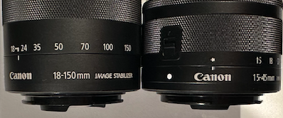

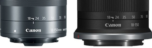

The EF-M 18-150's optics were re-housed in the RF-S mount with the same mount-side protrusion in terms of depth (pic from Camera Decision), and the EF-M 18-150 has the same mount-side profile as the EF-M 15-45 (picture from my copies of the EF-M lenses). Actually, when I look closely the rear element of the M18-150 extends a slightly greater distance from the mount surface than that of the EF-M 15-45 (less than 0.5mm by eye, but still slightly further toward the sensor than the 15-45).
Screenshot 2023-04-24 at 3.30.58 PM.png Screenshot 2023-04-24 at 3.20.42 PM.png
Thus, there's no objective reason the EF-M 15-45 optics could not have been rehoused in an RF-S barrel/mount, as was done for the EF-M 18-150.
Feel free to conveniently forget that fact as well.
