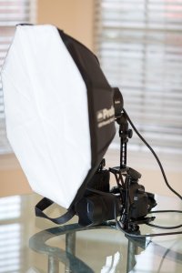

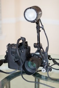

Yes, sounds like a plan. Just be careful about the size and verify that softbox does not get in the way when shooting with wider lenses. I have attached couple of snapshots of my setup with 40x40cm Godox softbox and it is a tight fit at this size already. 60cm would be a no go for me as I will see its lower edge in the frame. I am also not looking forward to manoeuvring though the crowd with such a large item. You gonna get people upset for being disturbed "for nothing".
