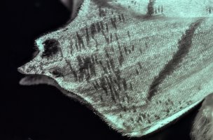

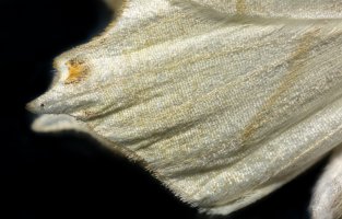

I'm currently sort-of experimenting with this myself. I don't have a modified camera or proper filter, but I've found the results with an astro light pollution filter quite good even if I'm crossing streams, so to speak :) Here's my first direct comparison (few flowers here at this time of year!), it's the rear underwing of a swallow-tailed moth, Ourapteryx sambucaria, in visible vs filtered UV light. Focus stacks using the MP-E and Affinity Photo. Surprisingly few moth specimens I've tried show much in UV but this one was interesting enough to persist with.
Neat. I think what you are doing is essentially a blue channel image. There are some faint yellow lines visible in the first image, and those are black in the second. Yellow = no blue, so those yellow areas will be dark. Compare the blue channel information from the first image with the second, and I would think they will be very similar.

If I follow you right, you're saying that desturating the green and red channels in the visible light image should give the same result, is that correct? I don't think that can be quite right. As a comparison, using this technique made green leaves bright red. That would not be the case if I did what I think you are suggesting.
I agree a modified camera must be better, but UV filters are sold for a reason - and not just to protect the lens's front element! The sensor must be sensitive to some UV, or otherwise to fluorescence in UV? I'm no scientist, so apologies if I'm way off :)
You're right, something else is going on. So most likely fluorescence, i.e. UV light is shifted into visible light wavelength.
All sensors are UV sensitive to around 320 nm, but there is filter in front of the sensor that cuts off UV at around 400-420 nm. That filter is taken off when a camera is converted, and replaced with a UV transparent filter. In order to take UV images, you need to exclude all visible light, and also the IR. Sensors are less sensitive to near UV than to visible light, so you need to exclude ALL visible light. If you look through your filter against a bright light source and you see anything, then it is not suitable for UV reflectance imaging. Hope that helps a bit.

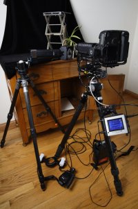

Here's am update on my experiments, with which I am quite happy.
Set-up: Canon 5D2, Lens Nikon EL 80 mm f/5.6, Baader U-Venus filter on lens, cheap Russian M42 bellows in between; various adapters all throughout. Illumination with Metz 45 CT1, removed plastic front shield and replaced with cheap Chinese UG11 equivalent filter. Aluminum foil on opposite side brightens right side of image. Metz is triggered via FlashZebra slave, with Canon MT26 EXRT connected to 5D2, firing single head at 1/512 power. The whole rig on Cognisys Stackshot. Have to put 10s firing delay in program, so that the flash can re-charge between firings. Flash head gets quite warm after 60-100 shots.
Processing through DxO with Premium noise reduction removing all color artifacts. No more messing with gaussian blur masks in AffinityPhoto. Easier, but takes a lot of time on computer. Then in AffinityPhoto, steepened a and b curves in Lab space quite bit (lower corners moved halfway to middle, so doubled slope). Plus a bit of fine tuning so that black background is neutral in color.
Biggest problem is low power of flash. Have to go to ISO 400-1600 at full power of flash to get enough UV through the system. May get two Metz 60 flashes, so that should get me in ISO 100-400 range.
Still no pattern on flowers, but there is some differentiation between flower and rachis. About 2.5:1, some 70 frames at f/5.6 and 100 µm steps.

So you are using a $1,000 flash as an optical triggering device to trigger an underpowered $20 flash? I don't see that as making any sense, why not just plug the Metz into the PC port on the camera?
But a simple 'studio' light is going to give you way more bang for the buck anyway and get you to the power output you need rather than mess around with AA batteries.

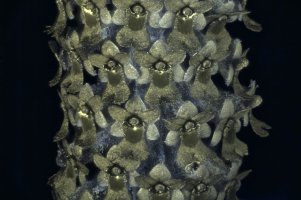

This right up front, this is not a great picture, it is a proof of concept, to be refined.
I am interested in UV reflectance photography and to see whether there are insect patterns not visible in "normal" light on some minute orchid flowers. The flower is 1.76 mm (no, not a typo) wide. Shot with full-spectrum modified 5D2, MP-E 65 at f/2.8, manually stacked 10 frames, Baader UV-pass visible opaque filter, ISO 400, about 4 second exposure, illuminated with single UV 365 nm LED flashlight.
First off, the MP-E 65 DOES transmit some UV. That's already great. I also have a Nikon EL 80/5.6 but still waiting for some parts to arrive to put it all together. Should have much better UV transmission, so will be interested to see the differences.
Further refinements are additional UV flashlights (can't diffuse them because of absorption and fluorescence issues), and stacking with StackShot (have that).
Some single shots on some other orchid flowers do show some different patterns, so that works as well. The dotted highlights, those are the individual cells, with their rounded surfaces (verified by scanning electron microscopy). In visible light, the flower is uniformly green.
