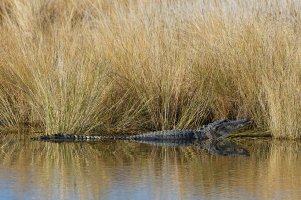

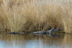

Here's a follow-up with an example of why a C-PL can be helpful for a super-telephoto lens. Here's a shot with no polarization (top) and a second shot with about 80% polarization (bottom). Were the light any harsher, the first shot would have had way too much glare on the scales to the point on being unusable, while the second would work fine. These images are unprocessed to show the full difference between the two shots:
