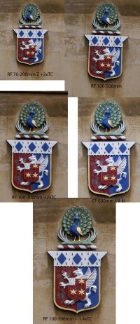

WEX was having a Road Show day today with Canon reps plus gear and I took advantage of it to do some comparisons of telephotos on my R5ii. The store in Cambridge is situated about 70m from the front of Sidney Sussex College that has some good targets for comparison. Here, I have selected crops from the centre of a shield and cockerel, and also dug up some images from a year ago from the RF 200-800mm and RF 800mm f/11 on the R5. With these copies of the lens: the image from the RF 70-200mm f/2.8 + RF 2xTC at 400mm is extremely good, as is the RF 100-500mm at 500mm; the RF 100-300mm f/2.8 + RF 2xTC at 600mm is softer; the EF 600mm f/4 iii is similar to the 100-500mm; adding the RF 1.4xTC to the RF 100-500mm at 700mm doesn't add much detail; and the two 800mm lens add clearly more detail.
6L8A0415-DxO_Sidney_Sussex_Shield_400mm_full_small.jpgSydney_Cockerel_Shield_collage_Annotated.jpgSydney_Cockerel_shield_800mm.jpg

Very interesting comparison.
Stunning IQ for the 70-200 Z + 2X, fully confirming TDP's quality results.
Even the inexpensive 800mm f/11 produces a convincingly sharp picture.

It was very helpful for me. I'm very tempted by 70-200 Z. Super sharp, not too heavy and takes the 2x so well. Neuro once wrote, I recall, that the 100-300mm with 2xTC is not as sharp as the RF 100-500 and that is consistent also with Canon's MTF charts. And I was disappointed with the RF 600mm. I could hand hold it for brief periods and f/4 is clearly very useful. It's not as sharp as the 600mm f/4 ii in the TDP charts, and it wasn't outstanding on the target here.

I do not want to lead you into temptation;), Gordon Laing from Camera Labs has a video where he compares the RF70-200mm, the RF70-200mm Z + extenders with the RF100-500mm. The RF 70-200mm Z with extenders is as sharp as the RF 100-500mm.

It's gone through my mind. For birding per se, I can put the RF 2xTC on the RF 100-500mm and get about the same resolution as the RF 200-800mm. (I'll try it out when convenient to compare the cockerel and shield image.) The RF 200/2.8 or 400/5.6 puts near enough the same number of photons per duck as a 500/7.1, so the signal/noise in both systems should be the same. However, it would be nice to have a super 70-200/2.8 for using native and then be able to do moderate birding with it. Even better on an R7 or R7 ii, which would have the reach of a 560mm on the R5ii.

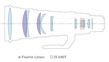

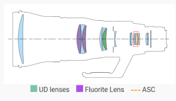

There was a significant redesign between the EF 600mm f/4L ii and iii. This shifted larger lens elements from the front to the middle of the lens, reducing total weight and making the lens less front heavy. Critical reviewers noted the significant reduction in weight but also a decline in image quality between the ii and iii.
To be fair, Bryan on DP Review said that there was a slight reduction in sharpness: "The version II lens has awesome image quality and the version III promises nearly identical results. ... The version III vs. II comparison shows the version II lens slightly sharper in the center of the frame with the difference becoming more apparent when extenders are mounted. The version III lens has considerably less lateral CA."

I'm thinking of a 70-200 Z + 2X to replace both the RF 70-200 (non Z) and the RF 100-500 when hiking in the Alps, saving much weight and space. 400mm are often more than enough for landscapes.
It's an almost incredible achievement to design a zoom which hardly suffers a loss of IQ when fitted with an extender.

Also consider the RF 100-400mm, it weighs and costs next to nothing, hardly more than a 2xTC, and gives very good images. If you are going to be using a 70-200mm at f/2.8, then the 2xTC is a great addition to make a 140-400mm f/5.6. But if you just want something in the 100-400mm range for general use, then the el cheapo 100-400 does the job. I'll test it on the cockerel and shield when I get time.
