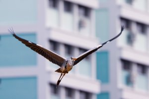

Attached examples below for the 2x TC. reduced to 50% for the crop and still yield about 6MP.

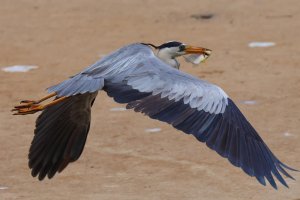

I shoot with Mode 1 for the BIF. Attached an example with 1.4x TC. I can see the view finder is more vibrate with my handheld with mode 3. Probably can do some try with mode 3 for the BIF later.
