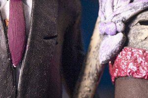

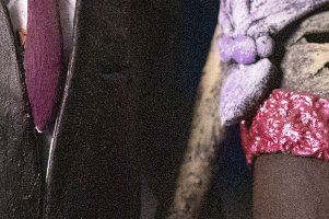

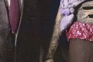

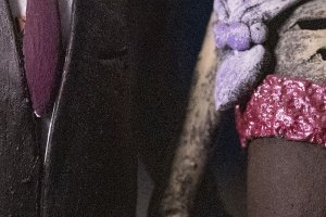

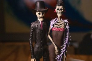

Trying to bring everybody the content that I would want to see if I didn't have my hands on an R5 yet. I did some comparisons of the R5 vs the EOS R for how well they can recover shadows in dark photos at various ISOs. All photos taken with an RF 50mm 1.2. (From here on I'm just going to refer to the EOS R as R.)
All photos were resized to the same dimensions to negate the different sensor megapixels. No noise reduction used anywhere.

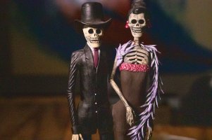

First, an underexposed photo at low ISO. I'm only going to include an original from the R5 here because the R didn't look too different.
R5, 1/60sec, f4, ISO 200
And brightened up version, R vs R5
R5, 1/60sec, f4, ISO 200, brightened 2.75 and raised shadows
R, 1/60sec, f4, ISO 200, brightened 2.75 and raised shadows
R5 detail, 1/60sec, f4, ISO 200, brightened 2.75 and raised shadows
R detail, 1/60sec, f4, ISO 200, brightened 2.75 and raised shadows
Next, same photo at 10000 ISO. But I did not intentionally underexpose it, so I'm not going to post the original. I just pushed the shadows up on both the R5 and the R.
R5, 1/800sec, f4, ISO 10000, pushed shadows by 100
R, 1/800sec, f4, ISO 10000, pushed shadows by 100
R5 detail, 1/800sec, f4, ISO 10000, pushed shadows by 100
R detail, 1/800sec, f4, ISO 10000, pushed shadows by 100
Same thing at 20000 ISO and then 40000 ISO
R5, 1/1600sec, f4, ISO 20000, pushed shadows by 60
R, 1/1600sec, f4, ISO 20000, pushed shadows by 60
R5 detail, 1/1600sec, f4, ISO 20000, pushed shadows by 60
R detail, 1/1600sec, f4, ISO 20000, pushed shadows by 60
And finally 40000 ISO.
R5, 1/3200sec, f4, ISO 40000, pushed shadows by 60
R, 1/3200sec, f4, ISO 40000, pushed shadows by 60
R5 detail, 1/3200sec, f4, ISO 40000, pushed shadows by 60
R detail, 1/3200sec, f4, ISO 40000, pushed shadows by 60
Overall I think the R5 is a little better. It's not the earth shattering improvement I would have hoped for, being about a four year newer sensor. But to pack 50% more pixels into the sensor and still have the noise be as good or slightly better, I'll take it.

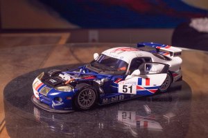

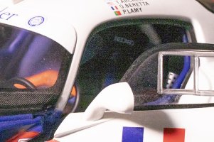

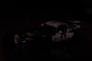

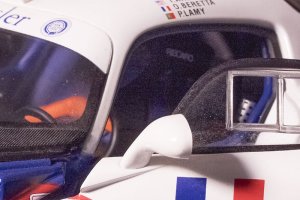

Ask and ye shall receive. I just figured I would do ISO 200 because outside of landscapes on a tripod, most people don't have the luxury of staying right at base ISO under most conditions. Anyway, here are a few more shots. I decided to use something with a little more detail in the shadows. Please ignore the dusty glass! :cautious:
All shots taken with the R are at firmware 1.4.0
R5 , 1/13sec, f9, ISO 100 (Again not going to include the R to compare the original since they're pretty similar.)
R5 , 1/13sec, f9, ISO 100, pushed 5 stops and shadows raised by 100
R , 1/13sec, f9, ISO 100, pushed 5 stops and shadows raised by 100
R5 detail , 1/13sec, f9, ISO 100, pushed 5 stops and shadows raised by 100
R detail , 1/13sec, f9, ISO 100, pushed 5 stops and shadows raised by 100
Actually the R5 looks like it has much less nasty color noise when you push shadows to the extremes!
Another detail crop of a darker area. The R5 definitely holds together better when recovering very dark shadows. There's a ton less color noise.

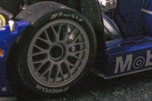

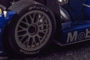

In light of the reports that the R5 applies noise reduction even on its raw files at low ISOs, I decided to do a comparison of the previous files, but I added noise reduction to the files from the R. I also corrected the white balance on both files so the "M" in the Mobil logo is set to be the neutral gray.
I think the R still has a lot more nasty looking green color noise that is not present in the R5 file, even after noise reduction is run on the R file.
R5 detail , 1/13sec, f9, ISO 100, pushed 5 stops and shadows raised by 100, white balance corrected
R detail , 1/13sec, f9, ISO 100, pushed 5 stops and shadows raised by 100, white balance corrected, noise reduction added
thanks for doing this. That has been my conclusion too. The R5 still retains more detail and colour information in the shadows despite any supposed noise reduction. It's honestly hard to see any ill affects of the noise reduction even if it is being applied. R5 images look very crisp/sharp to my eyes
I agree. I mean maybe the R5 raws at low ISO do have noise reduction baked in. But even if they do, I can't seem to replicate their clarity or color consistency in post with EOS R raw files.
