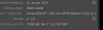

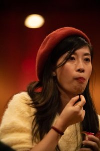

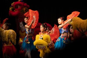

ISO 12800 is something which my 1Dx II handles very well but it is the maximum I’m willing to risk with a crop camera like the R7. So I went with Auto ISO limited to 12800, Time nailed to 1/500 and variable F settings. Result was an evening with nearly constant F 2.0 and occasional warnings about not enough light. I upload two pictures, I used Lightroom to export them at only 2 Megapixel from CRaw to JPG but did not apply any further development. Both are taken at:
With the Viltrox delivering the right F value with 2.0 but the wrong focal length which was 200mm rather than 142mm
Both pictures I would probably not have been able to take without the Viltrox. The Snapshot Portrait would not have required 1/500 but it was so dark that I would have had trouble to find proper focus with a slower lens (In fact with the equipment I had available 2 years ago I would not even have thought it possible to make such a shot. This was a scarcely lit theatre audience) . The second picture from the stage had very fast movement inside, 1/250 would have resulted in movement blur.

During the show they used a strong HDTV beamer to project the background image for the show, but not from behind on a translucent background but from front and therefore also onto the performers. The background picture almost always had some twinkling moving little stars which seemed to be highly attractive to the face recognition and especially eye focus algorithms of the R7 so focus constantly wandered off.
When there were no sparkling little critters another effect kicked in. Eye detection seems to go first towards the biggest eye, then to the most shiniest. I assume the algorithm believes that the biggest eye must be the closest. Bad luck if the eye you want is that of a small child but the camera sticks constantly on the painted eyes of the lion dancers costume in the background.
Since this was necrothreaded, I’ll point out that the EXIF is accurate. The speed booster is a 0.71x reducer (the reverse of an extender/TC). It changes the focal length and max aperture of the lens in front of it just like an extender. If you had put a 1.4x TC behind the 70-200/2.8, the long end would be a 280mm f/4 lens. Putting a 0.71x reducer behind the lens gives you a 142mm f/2 lens at the long end.
You are right I'm wrong, I was living in my own Micro Cosmos where the crop factor of the R7 worked for my mind as the equalizer back to 200mm but of course that does not affect EXIF
