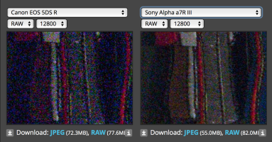

Let me be even clearer for you. Below, DPreview's test scene in tungsten mode, 5DSR vs A7RIII. First, without chroma noise correction :
Then, with the minimum amount of noise correction possible for each file so that most color blotches are eliminated :
See what's happening to the blue pants on the 5DSR file ? Well that's because the blue channel's noise is so elevated that C1's colour noise reduction algorithm has to undersaturated it so that it doesn't modify the grey point. DPP behaves similarly. LR's approach is to let the grey point shift (in general towards magenta).
That blue channel noise issue is far more important than nearly everything else for most people's low light photography. It wreaks havoc at all print sizes, even small ones, and it's most likely to occur under the sort of lights people tend to shoot at higher ISOs.
There's a whole stop of noise performance difference between the two in that regard.
By turning to the shadows of an underexposed and poorly white balanced tungsten image?
Did you grab the wrong file for Sony? Because the Sony pants aren't blue on their site.
Side note: with no NR of any kind it looks like the A7r III may be 1ev better at 12800 with a grossly underexposed tungsten image. The color splotching on the Sony is roughly equal at 25600. If you leave default color NR on the difference drops to <1ev again.
But...I wouldn't use a grossly underexposed 12800 tungsten image for any purpose from either camera. And performance in grossly underexposed tungsten images at 12800 is not relevant to the high ISO needs of anyone I know including pro photographer friends and casual photography family members. If anyone came to me with a Canon 5Dsr 12800 print like this test and complained about blue channel noise, I would not point them to a Sony. I would point them to an online course on exposure.
You know very well that the DPreview test scene isn't underexposed overall (clipping indicator in C1) :
And why shouldn't I look at what the shadows look like in a picture ? Aren't they part of the bloody picture too ?
Besides I neutralised white balance in the example above. By "poorly white balanced", are you actually suggesting that one can have the luxury to change the light bulbs at a venue when they fancy ?
BTW, the problem actually gets worse if the white balance is neutralised. That's because under tungsten lighting, it means boosting the blue channel relative to the others. If its noise floor is high, you start to run into the phenomenon that you can see in the picture above.
Are you colour blind ? No really, I sincerely ask the question. In the example that I showed, the guy on the right is clearly wearing blue pants. They turn to grey on the Canon because that's how C1 or DPP handle that blue channel noise (by desaturating it, to keep greys reasonably neutral).
You know very well that the part of the DPReview tungsten scene which you choose IS underexposed. They basically light one side of the tungsten scene. You pick the unlit side to complain about noise, then pick the lit side to say it's 'not underexposed.' If you need to play games to support your claim, your claim is not true, or not true outside very narrow margins.
If pixel peeping deep shadows of poorly lit tungsten shots at 12800 is your thing, knock yourself out. Just don't expect that to be meaningful to actual photography.
I had the wrong section under the magnifier when I wrote that. Should be obvious from the screenshot but rather than be an adult about it you decide to be a child.
They turn to grey on the Canon because that's how C1 or DPP handle that blue channel noise.
ACR doesn't.
What ACR does, and what you can already see in the very picture you posted on your own, above, and without even pixel peeping, is that the areas that should be dark and black / grey, are in fact dark blue / purple / magenta. Don't you see that ?
This is why DPP and C1 desaturate the blue channel in these conditions. To keep greys neutral.
And this is why I consider elevated blue channel noise the n°1 problem at higher ISOs : you can still see its effect in a thumbnail.
What you don't get...
I get it and I don't fully agree.
I never posted a picture developed in ACR. I've posted screenshots from dpreview. And I'm tired of nitpicking this point. The A7r III's 25600 RAWs are not as good as the 5Dsr's 12800 RAWs which means it's <1ev ahead at high ISO.
Isolate the blue channel shot under dim tungsten light with a full moon and Jupiter and Saturn aligned. It doesn't change a thing.

I disagree with you assessment. The reason I always bring up the issue of blue channel noise under warmer TCs is that not only is this is the sort of lighting where you're very likely to be actually taking pictures, it's also something that will affect how a picture looks regardless of its print size. The way Lightroom deals with this is by turning darker areas magenta. The way C1 and DPP deal with this is by reducing the blue channel's saturation - resulting in a loss of colours.
