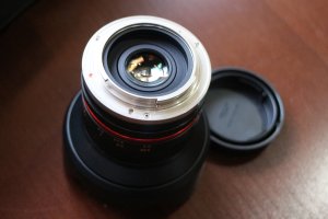

Have you ever tried to use a dandelion chip?
In my rokinon/samyang 16mm i have attached a dandelion IV canon chip and works quite well with my 1Dx.
http://www.peleng8.com/af-lens-adapters/af-chip-dandelion-af-chip-dandelion-iv-generation-for-canon.html
You can program it in a way that the files will retain the F stop used.
its also quite inexpensive (+/- 20 USD). While the AF confirm is a bit wide (i think it can be adjusted somehow) it does work quite ok.
here is a link to some of the parameters it can be programmed.
http://filmprocess.ru/oduvanchik/instructions/programming_en.html
Had no problems with it, and might be the solution to your problem. It does take some adjusting of the position so that the camera detects the chip but once thats done, it just works.
This being said, i hope in the future rokinon included such a chip in the lens itself.
Not sure the same chip exists for other camera systems, but it somehow solved my problem.
