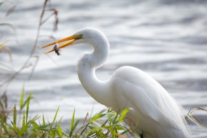

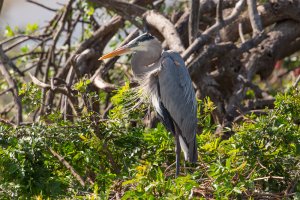

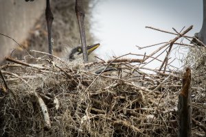

Whereas 18 months ago, the super telephoto zoom field was limited to expensive or older options, it is now very interesting with a number of good options. I consider the 150-600 sports to be one of those good options, especially if you want something that goes out to 600 mm.
Most of these where shot mid-day, so maybe not the most artistic of shots, but I think do illustrate what the lens can do. BTW, the GBH chick shot is a ~100% crop, the others are also heavily cropped, but not approaching 100%.
very sharp, nice Bokeh.
