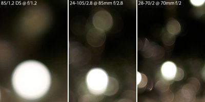

Just for kicks, I compared bokeh balls on the tree behind our kitty with two other lenses, the RF 24-105/2.8 and the RF 28-70/2. These are 100% crops, the shots were taken from the same distance.
For the more OOF (and dimmer) lights at the top of the frame, you can see that the 85/1.2L DS shows just a soft blur, the 24-105/2.8 shows harder-edged circles with a brighter outer ring, and the 28-70/2 shows harder-edged circles with some onion-ring effects.

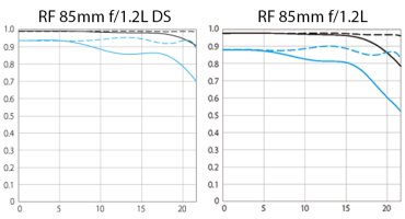

In fact, the 85L DS is actually sharper than the non-DS version. You can see that in Canon's MTFs and in Bryan/TDP's ISO 12233-type chart comparison.
I thought there are no differences between the two glass-wise, right?
