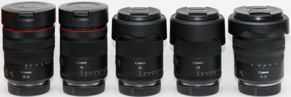

As is obvious from the above image, the RF 14mm f/1.4L VCM is very similar to its VCM siblings, and also something of a slimmer version of the RF 10-20mm f/4L STM lens. The build quality of all of them is similar, though the 14/1.4 feels a bit more dense.

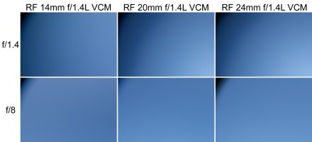

When I tested the 20/1.4, I was surprised to find that wide open mechanical vignetting was a bit less on the 20/1.4 than on the 24/1.4. Turns out that's a trend, since it's even less with the 14/1.4. It's still present after stopping down to f/8, somewhat reduced but not as much improvement as with the 20mm lens. The images in the composite below are the upper left corners of RAWs exported from DxO PhotoLab 9 with no corrections applied.

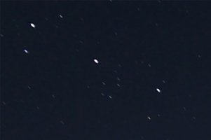

Obviously, starscapes are going to be a primary use case for this lens. The full moon in the shot of the cemetery above hints that it's not the best time of the month to shoot such images. and my usual test subject (Ursa Major) was very close to that moon. Instead, here is a 100% crop of the extreme upper left corner of the image, composed with Orion's Belt right next to that corner in the camera's LCD.
EOS R1, RF 14mm f/1.4L VCM, 13 s, f/1.4, ISO 100 (in-camera JPG, 100% crop)
Coma is very well controlled in this lens, although there is some tangential astigmatism (with virtually no sagittal astigmatism). Here's just Orion's Belt at 400%:

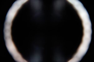

One other bit of trivia about this lens. For those into lens cap photography, this is not the lens for you...but the light leak with the cap in place is rather interesting.
EOS R1, RF 14mm f/1.4L VCM, 1/4 s, f/1.4, ISO 51200 (NR in DxO)

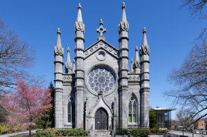

Another advantage to the wide FoV, as long as you're willing to crop away half your image, is that you can avoid the keystone effect in architecture shots by keeping the camera level and still get the whole building in the (top half of the) frame.
"Mount Auburn Cemetery Chapel"
EOS R1, RF 14mm f/1.4L VCM, 1/800 s, f/4.5, ISO 100
