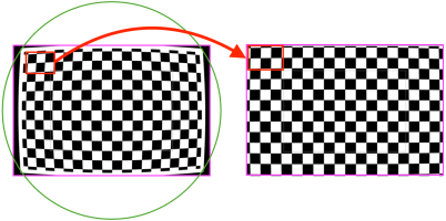

No, that is not correct. It's not using some sort of AI / generative fill to guess what should be in the corners. The light that 'should have' fallen on the corners is distorted further into the frame. The distortion correction algorithm is interpolating from the 'compressed' areas near the corners of the image and 'stretching' them back out to fill the corners.

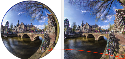

Consider the extreme case of a circular fisheye lens being defished. Defishing is not cropping a square/rectangle from the circle, and it's not using generative AI to fill the corners. It's correcting the fisheye image to produce a rectilinear image. The part of the image that is in the corner of the defished image was in the original image. Those pixels were not 'invented', they were stretched into the corners.
Obviously, the magnitude of the correction matters. Correcting a circular fisheye image to be rectilinear has a cost in terms of resolution. The 5-8% distortion needing correction in an RF lens that doesn't fill the corners is much less costly, and in line with my overall point, correcting those corners optically is not somehow perfect. There's a resolution cost in the corners for making a lens rectilinear, and even so many 'optically corrected' UWA lenses are left with 4-5% barrel distortion (that distortion is usually corrected with software, anyway).
What I was saying is that the rumoured specs from the patent of the RF14mm f1.4 VCM are 14.4 mm focal length, with quite a short image circle. With Software (non generating) profile this would yield noticibly less that the stated 14mm focal length.
Again, there's no generative fill happening. Just distortion correction. With software correction, the corners will be filled.
The reason that DxO can deliver an even wider image with 'extra pixels' on the sides (as @Nemorino noted) is simple geometry. The image circle is a circle (duh) and the sensor is an inscribed 3:2 rectangle. That means that magnitude of barrel distortion is going to be relatively greater in the horizontal direction than in the vertical direction, so to correct the distortion the image will need to be stretched further in the horizontal direction. DxO simply allows one to use all of corrected area by not cropping the output back to a 3:2 ratio.
I think this is the point a lot of people are missing - or in some cases actively ignoring. The question of whether an equivalent 'optical correction' is better or worse obviously depends on the circumstances, but the point of including digital correction is often about size and cost savings, and surely what really matters is the standard of the images that emerge from whatever process is taken to capture and correct them?
People also often miss the point that the distortion is present across the entire image. If you look at just the center portion of the checkerboard on the left, it’s still distorted. The gray APS-C frame makes it easy to see. Obviously, that’s true for all lenses, not just for wide/UWA mirrorless lenses that don’t fill the corners. So the ‘stretching’ starts at the center and moves radially (and non-linearly) out to the periphery.
In other words, it’s not just the corners being stretched – it’s the entire image.

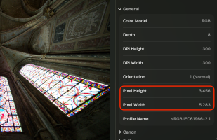

One more point on this, just to drive it home. The EF 11-24/4L is a DSLR lens, so it's 'optically corrected' and the corners are filled by the lens. However, when you apply the lens profile to correct the ~4.5% barrel distortion at 11mm and export without cropping to the 3:2 aspect ratio, the resulting image is wider than the sensor.
For example, this shot of the interior of the Saint-Gatien Cathedral in Tours, France was taken with the 1D X and 11-24/4L at 11mm. The final shot is a 5-shot HDR image, but the individually exported images are 5283 x 3456 pixels, even though the 1D X sensor is 5184 x 3456, i.e., the distortion correction stretches the image of this 'optically corrected' lens anyway, adding 99 pixels to the width.
So the takeaway is that what’s being done to correct the RF lenses that require such correction because of a slightly smaller than FF image circle is the same thing that’s done to lenses that don’t require such correction to fill the frame, it’s just that the magnitude of the correction is a bit greater.
I still have no idea why the need for correction of some lenses seems bothers some people so much. Personally, I believe the ~4.5% barrel distortion of the EF 11-24/4 requires correction, as does the ~5% distortion of the RF 24-105/2.8.
Maybe some people are bothered by it being ‘forced’, but I suspect much of the complaining results from a lack of understanding and/or flawed assumptions (including those propagated online), like the incorrect suggestion that generative AI is being used to fill in the corners.

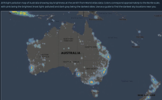

I envy your skies!
I envy your skies!
Australia is a big place!
Although Bortle index vs Zenith brightness are different, it would be a minimum 2 hr drive east and up 1000m to get to Bortle 3.5 (Mount Victoria - Blue Mountains) from my house in Sydney but still need to face west away from the Sydney glow.
This shot was from Mungo national park which is a 10 hour drive west of Sydney and would be Bortle 1.
Mungo is still very much within the same state as Sydney ie New South Wales.
Western Australia would be a better option from the UK. Fly direct to Perth for 16 hours and then drive in any direction from Perth into dark skies plus lots of other photography genres as well as astro.
