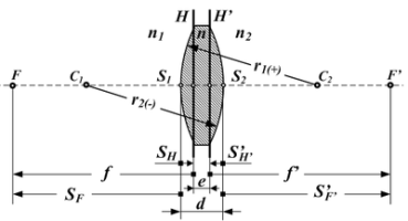

Science require control of the variables. Too many variables and you can conclude nothing.
Photography isn't a science. If you don't include all the variables you end up with purely academic test results that have extremely limited, if any, real world value.
In my opinion, the picture on the page is photography, but the benchmark performance of different optics is optical lens science. http://www.answers.com/topic/lens-1 There is no objective way to measure photography. But, there is, (and needs to be) a way to objectively measure lens performance. And, like all science, the best testing measurements require the best scientific method, which includes limiting variables to (hopefully)- one. Pax.
