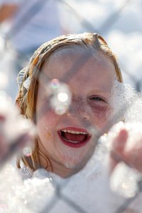

Here is a worst case example, shot with a 200-400mm f4 lens. At 400mm and F4. Lens hood against the fence.
The Photo:

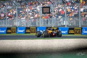

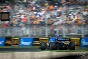

Problems occur at motorsport with debris fencing as often you can't get close enough to it and it reflects back into the lens causing soft images. For this the trick is to find spots where the fence is in shade. Here I was in the shade about 6m from the fence (also shaded) shooting with a 200-400 @ f13 to get the shutter speed down as panning helps remove the bars. I was using a CPL but could have added a ND filter to get the aperture closer to wide open.
Another shady spot but with a higher shutter speed and wide open at f5.6

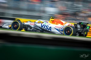

Another slow shutter image but the shaded bars are appearing as black in the light part of the image as the subject moves away rather than sideways through the image.

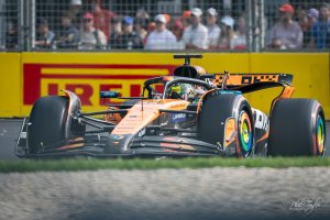

And this is what it looks like at a higher shutter speed wide open at f4

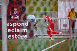

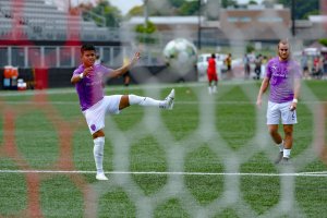

Here I was shooting through the soccer goal trying to get some visible netting in the photo. I was about 10 feet back. In the top photo pressing the camera to the net may have resulted in camera damage or bodily injury. They seemed to be targeting me.

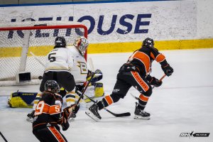

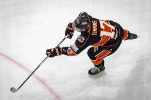

Yes, they will identify something to target when shooting at goal and that's why my ice hockey netcam always goes in after the pre-game warmup. I saw someone put a go-pro in the net once and the players targeted it during the open net shots = one destroyed go-pro and a game delay while they picked up the shattered pieces of it of the ice:LOL:

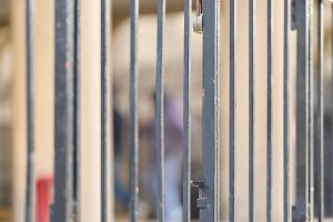

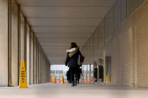

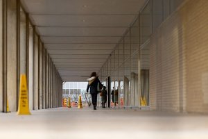

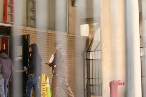

A few days ago, I shot through or past a wrought iron fence. When I got close enough, the bars all but disappeared. There were 2 shadows that replaced them. I used an R5m2 and an RF 135mm f1.8 lens. The aperture was set at f1.8. The 1st image was made of the fence. The 2nd, 2 construction workers and 1 United Parcel Service worker entering a doorway. The 3rd, the woman closest to the camera is the subject. The 4th, the woman in the background is the subject. I understand the wrought iron bars were out of focus, but what about the lens and photons makes them look like they disappeared? The women were in a breezeway that is to the left of where the 3 men walked through a doorway. The same fence is there. I was very close to the fence, but I didn't allow the lens hood to touch it.
