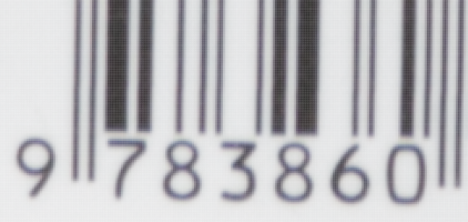

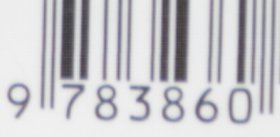

I bought the Sigma 150-600C one year ago. Until now I have to say that this lens is very impressive.
I use it on a Canon 7DII, a very high pixel-density camera. The AF is fast, the stabilzer allows usage of 1/320s handheld at 900mm. The lens is lightweight and compact. It fits very nice into a backpak so it is carry-on baggage capable. The build quality feels as good as the new plasticy Canon L Lenses, only thing is I dont trust the weather-sealing. I use it only when its dry outside. All that for a $900 Price Tag.
As I wrote I use the canon 7d mark II so sharpness should be a problem but there is none (At least my copy looks very sharp). To show the sharpness of my copy I took some pictures of a barcode from a book.
30 feet away, 500mm, Zero Sharpening, Neutral Cameraprofile, Exported from Lightroom, Zoom on Pixel-Level (about 8:1)
Picture 1: Centre f6.3 wide open
Picture 2: Centre f8.0
I have a question: Did somebody the firmwareupgrade and if so, did the lens improve?

AlanF said:
I don't understand the pixel size of the barcode image. Do you mean that 8 pixels of the barcode = 1 pixel of the original image?
No. Im sorry I dind'tmade that clear. For the comparison I viewed the picture in my 4k Monitor. 1 Pix from the Camera = 8 Pix on my 4k Monitor. If you look at the Barcode-pic in full res you can see the Pixel-Grid.
I have to add that the Barcode is not exact straight up but a little bit tilted, so full pixel sharpness is physically not possible. Im sure Canons big whites are better but valure for price is incredible.

It would be simpler to post a straight crop from the picture where 1 px = 1 px of the original rather than an upresolved image.
