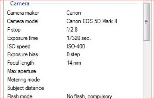

alek35 said:
mrsfotografie said:
Samyang 14mm: One of the most arty lenses I own. The 'moustache' distortion is no dealbreaker for my use of this lens. Excellent sharpness and colors and the (self added) addition of an AF confirmation chip makes it sweet to use (MF is otherwise almost impossible due to the large DOF in the viewfinder, even with an EF-S screen).
This got me curious - how did you add the AF confirmation chip ? It works on your Canon, right ?
Br,
Thomas
It works on any Canon EOS camera :)
I bought an AF confirmation chip and glued it onto the rear of the lens as shown in the pictures below. I positioned it in the right place using the supplied alignment tool and checked it with a Canon lens. Note that I had to make a spacer to raise the chip to the correct level: flush with the edge of the metal mount. If you glue it inside the recess it won't contact the pins in the camera!
The chip is programmable so that it will report the correct focal length and maximum aperture but will work without programming.
More importantly, it has internal 'focus micro adjustment' which I programmed at f/4 to nail focus every time and give sharp results at f/4 and above which is the aperture range I use mostly. I found there is some focus shift in this lens depending on aperture so at f/2.8 and f/3.2 the focal plane is not the same as at f/4 and above. Programming the AF chip at f/2.8 therefore results in a false calibration for the stopped down apertures.
Now, for stuff at infinity focus, the focus confirmation is still OK even at f/2.8-3.2 but for stuff critically close to the lens at wide apertures I resort to the precision matte focus screen in my 5DII to check focus is in the correct place.
The chip is programmable as follows:
Samyang 14 mm: 14mm F/2.8, AFMA 26
Preparation:
1 Turn camera on and attach adapter with chip,aperture shows F1.4 on camera.
2 set Manual mode.
3 shutter speed to 1/60 second
4 aperture increment step to 1/3 EV. (it is the most Canon digital camera default setting).
set the aperture value to F/64 and press shutter button once.
set the aperture value to F/57 and press shutter button once.
Turn the aperture dial, set the Max aperture to F1.0.
For example: 14mm f2.8 micro adjustment 24
Enter programing mode: F64 shutter, F57 shutter, F64 shutter
Setting focal length
Setting focal length mode: F2.2 shutter
Enter focal length value: F2.0 shutter F2.0 shutter F2.0 shutter F2.2 shutter F3.2 shutter (00014)
Store parameter to chip: F57 shutter F64 shutter F57 shutter
Focal length setting done to 14mm.
Setting Max aperture
Setting Max aperture mode: F2.0 shutter
Enter Max aperture value: F2.8 shutter
Store parameter to emf chip: F57 shutter F64 shutter F57 shutter
Max aperture setting done to F2.8.
focus micro adjustment mode: F2.5 shutter.
Enter focus micro adjustment value: F2.5 shutter F4.0 shutter.
Micro adjustment setting up done as 26.
Note that it is possible to have the Exif report the actual aperture selected, but I use the lens with the camera set to aperture priority and maximum aperture ( f/2.8 ), then I stop down the lens manually and let the camera sort out the metering. This works the easiest but it does mean that if I actually take a photo at f/5.6, it is still reported as f/2.8. Focal length and exposure time are however always reported correctly.
