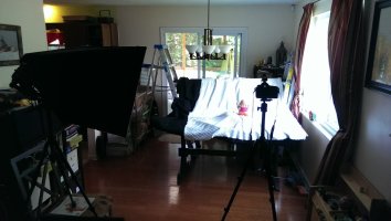

Thanks Ian,
1) I shoot in manual flash control and manual mode on the camera so that I have full control of how the exposure.
2) As I don't own a light/flash meter, I just judge the exposure from a few test shots and their histograms. I would like to have a light meter and shopped around a bit for one, but I can't really afford one at the time being so I'll stick to the trial and error method for now.
I understand the relationship between source size/distance and the quality of the light, but I was initially shocked that on full power using a 33'' reflective brolly box, I had to place the flash at less than one meter to obtain a decent exposure. I felt that there was not much room for composing the shot. However, It appears that a fresh set of batteries and being rigorous on testing solved the problem. It appears that for a head shot, I have a decent exposure at 1/4 power and the light at 2m from the subject.
