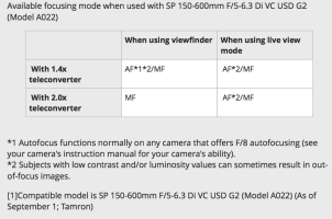

FWIW, this was posted at DPR regarding the AF capabilities (see attached), but I could not find that information on the tamron hp
https://www.dpreview.com/news/1288769210/tamron-announces-new-1-4x-and-2x-teleconverters

I have no doubt the 1.4x variant will work, as the effective aperture will still be presented as f/8 electronically just as the f/6.3 aperture presents itself as f/5.6. The 2x, however, I don't understand. It might still AF in DPAF Live View...but I'll have to test it and find out in what scenarios it works.
It should AF in any live view, just faster with DPAF.
