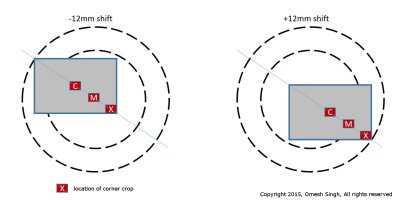

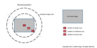

Brandon, while tilt may be in effect the major difference is the location of the crop being taken in the image circle:
I would think the tests are done with vertical or horizontal shift (not diagonal) but the end result is the same, differential positioning relative to the edge of the image circle.
