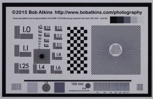

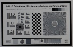

Shots of a chart from the 100+400mm II + 2xTCIII are similar in resolution to those from the 400mm DO + 2xTCIII. Here is a shot of ~4000px x2600px from the centre of the 90D + 100+400mm II + 2xTCIII, compared with the best resolving combo I have, a 500mm f/5.6 PF + 1.4xTC on a D500. The 90D shot (top) has been downsized 30% as it is too large to be uploaded here. The 700mm PF is sharper than the 400mm DO II at 800mm, both at f/8, and resolves better, despite being shorter.
Edit - the site has reduced the sizes to a width of 2048 px.IMG_8969-DxO_Canon90D200-800mm-lss_downsized30%.jpgDSC_4425-DxO_NikonD500PF500_700mm-lss.jpg
Edit - the site has reduced the sizes to a width of 2048 px.View attachment 192306View attachment 192307
Thank you. i’m not very impressed by the 100-400mm + 2X, but damn, the Nikon 500 + 1.4X is impressive. I can‘t jump ship now, but can hope for Canon to bring out a 500mm f5.6 as good as the Nikon. Larger aperture lenses than this are just too heavy for me to hold. In the mean time, I will have to content myself with not going beyond 1.4X on the 400mm.
