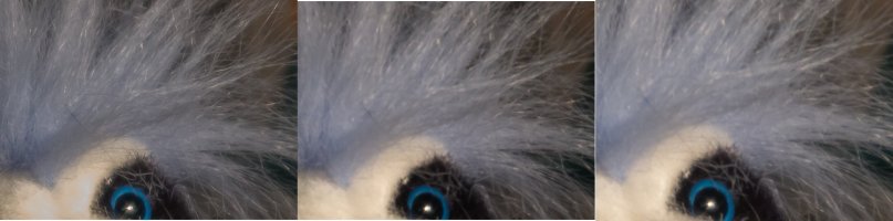

What does a teleconverter do for you if you wish to resolve fine details on a distant object?
The point that I am trying to make is that unless you have a really sharp lens, you are better without teleconverters.
My past experience is that using a crop body, if you have an ultra-sharp lens (like the series 2 big whites) a teleconverter will improve your resolving power, if you have a sharp lens (quality of 70-200F4) it is neutral, and if you have a soft lens it will hurt you.
The test is to capture photos of a small bird from 25 feet away. Since I can not get a bird to pose for me as I change lenses, I substituted a bird sized stuffed animal. All shots were cropped to the same portion of the bird's head and all images resampled to 500 pixels wide. unfortunately, I do not have a "big white" at home so that part of the test is left out... so the sharp lens used is a 70-200F4 and the soft lens is a Sigma 120-400F5.6. To make things interesting, a SX50 was thrown in as well.

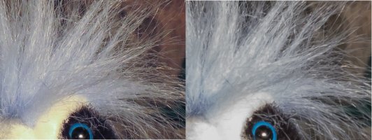

The first pair of pictures is the SX50 at 50X zoom and then at 200X zoom (digital zoom enabled).

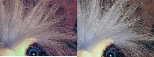

The second trio of pictures is of the 70-200 at 200mm, with a 1.4X teleconverter, and then with a 2X teleconverter. The third trio of pictures is of the 120-400 at 400mm, with a 1.4X teleconverter, and then with a 2X teleconverter.
In the first set, we find the image with digital zoom turned on is better than without. This came as a surprise to me as I had always assumed that digital zoom was an evil to be avoided......
In the second set, we see that the addition of the 1.4X teleconverter makes the image slightly better and that the 2X teleconverter makes things worse.
In the third set the teleconverters just degrade the images.
Something particularly important here is that a sharp 200mm lens provides more detail of that distant object than the soft 400mm lens.... but the most shocking conclusion is that a p/s camera (the SX50) can out-resolve both.
The last picture is the SX50 at 200X on the left and the 70-200 at 200mm on the right....

This is a hot button topic, each of us has their own perceptions and experience. Since various lenses and TC's have differing amounts of sharpness, the results individuals get will vary widely, and add into that the other factors that make each shot different. I haven't seen any authoratitive studies done, but the carefully done ones tend to support the view that cropping can be effective up to a point.
I tried to compare what I thought were carefully taken distant shots and found the results to be inconsistent, sometimes a TC was better, sometimes a crop.
Agreed.
My conclusion was that for MY lenses that the sigma 120-400 was for all essential purposes, worthless. A smaller/lighter/faster lens (the 70-200F4) is wider and will resolve further than the sigma. It focuses faster and is easier to use. I can't think of a single way or scenario in which the 120-400 is better.
It's a good thing to test your gear and find out what works for you...
I posted this because I thought that some might find it interesting and it would be nice to hear about other combinations that work or that fail.
The biggest surprise is how well the SX-50 works.... but be warned, it only works like that on objects that are not moving... it has glacially slow auto-focus and shutter lag so bad that sometimes you wonder if it is still working.
@Don: Before I comment any further...is it safe to assume that you maintained subject framing for each and every photo, or did you keep the camera at the same distance and only change the focal length?
The reason I ask is, if you normalize subject framing, then in every single case, fewer optical elements will be better. That does not, realistically, demonstrate the real-world use case for a teleconverter, though...which is to increase focal length to get you more reach from the same camera distance (and, therefor, enlarge the subject relative to the frame).
I am not saying your analysis is wrong...just that if you maintained framing, it doesn't actually demonstrate the strengths of a TC in the situations they were intended to be used. It would be very cool if you could re-do the test, but keep the camera at the same physical location, and scale up the crops to the same dimensions as the images with the TC's attached. (Would be best, in that case, to start with the subject filling the frame at the longest possible focal length, then work backwards to the shortest focal length from there, and crop to maintain framing after the fact.)
