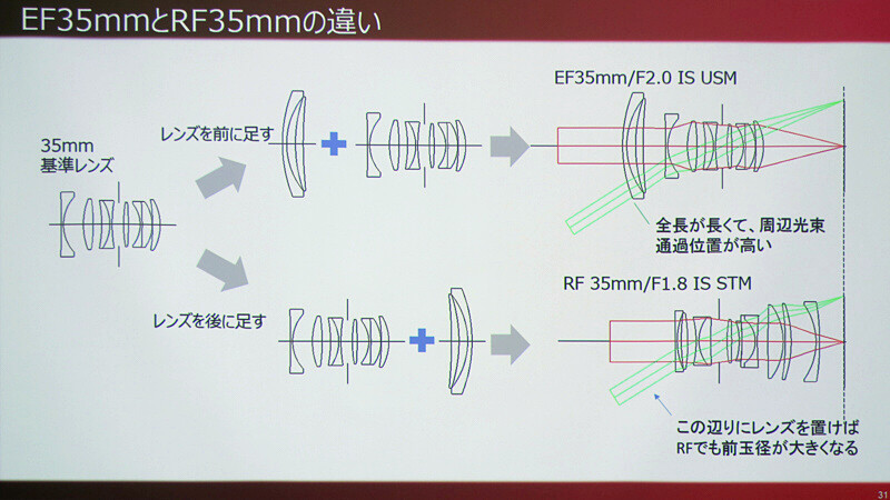

DCWatch has posted an internal Canon presentation about the advantages of the RF mount’s large diameter. Canon describes why they developed a new mount over using the existing EF-M mount. The large diameter of the RF mount allows for simpler and better-balanced lens design.
The RF mount allows for the larger lens elements to be near the rear of the lens and closer to the camera mount and the image sensor. This should provide better balance when larger aperture lenses are affixed to the EOS R. While this could technically have been done with the EF-M mount, it’s far easier for Canon to design lenses for the RF mount.
Comparing EF and RF lens design...
Continue reading...
Looking at the photo sample of the 35mm lenses, it is shocking how small the front glass is on the RF version. Traditionally I always thought aperture was a formula of front glass size in relation to lens barrel length. Or maybe I am wrong and it is barrel size not front element size?
from the single lens formula just calculate it: f/2: 35mm/2 = 17.5mm diameter. f/1 lens: 35mm diameter...
AFAIK, it's the entrance pupil - not the front glass size. For some kind of lens designs they can be quite close, but for others they're not. Retrofocus designs have large frontal lenses, but the entrance pupil is smaller.
If you look at the two lenses, the pupils are quite alike, despite the different size of the front lens.

actually, the diameter *IS* very important. it's a combination of lens registration distance and mount diameter that gives the flexibility.
which is why they didn't use the EF-M mount. they could use the EF-M mount, and the article states that Canon even considered it.
the larger mount diameter allows them to "flip" the elements around, and not use an element to "spread" the light across the entire sensor.
This is why when I wrote CN's article, I compared the RF lens to a similar Sony FE lens, and the differences are as Canon discussed in their presentation.
it is and was rather obvious all along. fairly simple geometry. i stated many times that well chosen mount parameters relative to image circle cannot be understated.
of course Canon could have "pulled a Sony" and used APS-C optimized M-mount also for FF. But it would have resulted in the same design restrictions that Sony FE lenses suffer from: lenses that are too big, too heavy, too complex and too expensive.

This explains why the RF 50mm f1.2 does not have as large a diameter front element as I would have expected.
F stop has to do with the maximum diameter of the diaphragm. Divide the focal length of the lens by the diaphragm diameter, and you get the f stop.
The size of the front element group mostly determines how much light is gathered at the edges and corners. Bigger front elements give less vignetting. It’s not entirely that simple, but that’s the gist of it.
A very short backfical distance allows smaller lens elements overall, because the rear element group still is smaller than what the front would have been. What I’m seeing with all the illustrations here, and elsewhere, is an exaggeration of the size of elements for lens designs for mirrorless. The reality isn’t so exaggerated.
