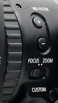

Maybe the RF L PZ lens will have a different design than the current RF-S PZ lens. It's certainly possible to have a freely rotating ring coupled to the zoom motor, my Vixia HF G60 camcorder has a freely rotating, knurled ring in front that can be used for focus or zoom (controlled by a switch next to the ring).

The implementation is not ideal, IMO, but better than the two-speed rocker on the RF-S 14-30. The zoom speed varies with ring rotation speed, but there's a short but still noticeable lag between when I start turning the ring and when the zooming starts. For example, I can give the ring a very quick, short rotation and then the camcorder gives a short, quick zoom that happens after I stopped rotating the ring. The process just feels a bit imprecise. Personally, I use the ring for manual focusing and stick to the rocker on top for zooming.
