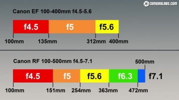

100-500 will read f/5.6 @ 400mm if you change the aperture increments to 1/2 stops instead of 1/3 stops, but the aperture is wide open regardless. I tested it at both f/5.6 using the 1/2 stops setting versus f/6.3 using 1/3 stop setting by looking into the lens and pushing the DOF preview button – same opening size for both. But you do get a brighter exposure using 1/2 stops increments and f/5.6 versus 1/3 and 6.3 – I tested that in full manual. It's possible the physical aperture size is right between the two at f/5.95 – or it's also possible Canon is faking the 5.6 brightness in order to honor the 1/2 stop setting.
1/3 increments are more precise. Even if you read f/5.6 the ISO needed for the same exposure as with 100-400 will be a little higher or the image will be slightly underexposed.
I tested it in full manual. SS/A/ISO all set to a fixed value and changing from 1/3 and f/6.3 to 1/2 and f/5.6 gives a brighter exposure. Canon might be jacking with the sensor gain without recording it of course.

This chart is for the default 1/3 aperture increments setting. When set to 1/2 increments, it does f/5.6 at 400. But I'm saying with either setting the lens aperture is wide open, so Canon must be applying gain to the exposure to brighten f/5.6.
