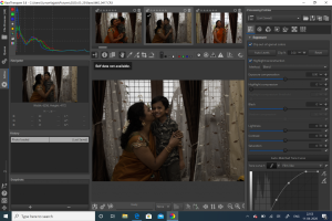

I wanted to check other softwares for processing RAW files for my EOS RP and I came across Rawtherapee (RT). When I open the RAW files using RT, I notice couple of things. First, the exif information doesn't come up and second, the picture looks soft and has desaturated colors compared to the view in DPP 4.10.
Has anyone used RT for EOS RP? Does one have to tweak settings to match the output of DPP with RT? Also, when I open the raw file in DPP, I see the image. Am I looking at the embedded image or is it the true RAW image? I think it is the embedded JPG that I am viewing as I know how the raw image looks like as I had used Fastrawviewer/Rawdigger before.

Sorry for the late reply @jvillain. How do I check if this has the latest libraw? I suspected that my RT 5.8 has an issue with the RAW files of EOS RP (.CR3) as it doesn't show any EXIF data. At the same time I also thought that if it doesn't support RP/CR3 then I shouldn't be able to open the RAW file. Are there any settings I should be worried about?

I read from a post in the DPReview astrophotography forum that Rawtherapee does a good job (in handling noise?) in demosaicing the RAW files. Hence, I thought I will experiment with it. The issue I have is that the image previews from DPP and Rawtherapee are completely different. If the differences are with respect to WB then I can understand. However, I am seeing that the raw files (embedded jpeg?) look softer in Rawtherapee.

Thanks @LDS. I don't have the resources to make a ICC/DCP profile for the camera for now. I will do it when the lockdown ends. I understand that these profiles are for color calibration. The main issue I noticed was that the lack of sharpness in Rawtherapee (I visualized the RAW data in Rawdigger too).
