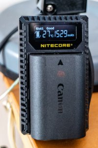

The Nitecore charger is simply brilliant! Smaller and lighter than the Canon LC-E6E and MUCH smarter. It assesses the condition of the battery once mounted. Two Canon LP-E6 batteries that score a single red bar in my cameras (yet hold a charge well) were displayed as "good". It then provides information on the voltage and charging current, as well as charge status, whereas the LC-E6E only provides charge status. It also displays temperature and total mAh fed into the battery. One of the photos shows that a relatively new Canon LP-6n battery that had shot almost 700 frames on by EOS R and was down to 1 bar on the display, took 1529 mAh. This should give a good indication of how much capacity my old and new batteries have, including the Wasabi.
