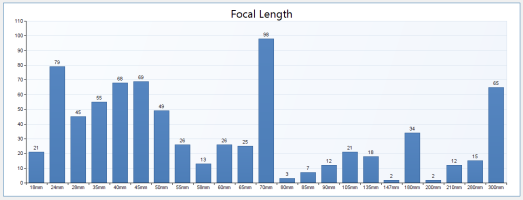

I have been on two landscape photo trips to Iceland, both trips a week long. On the first trip I brought a Zeiss 18/3.5, Canon 24-70L and Canon 70-300L. Om the second I had sold my Zeiss lens (to buy the 16-35/4L, but I did not receive it in time for the trip) – I was missing a wider lens then 24mm on the second trip.
The attached graph is what length I was using (on my keepers) for my two trips. I was only using full frame cameras.

This chart shows that the photographer tended to use his zooms at the extreme ends, i.e. 24, 70 and 200mm. I found that this was the case too when I travelled with zooms. I now travel light and find 35mm and 85mm to be less limiting than I expected. 35mm images can be stitched to go wider.
