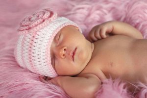

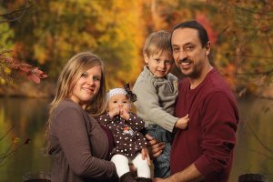

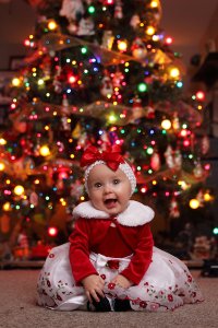

I shoot with a crop body (60D), I do a lot of people photography, a lot of it indoors, and I use the 50/1.4, the 24-70/2.8 II and the 70-200/4.0 so here is my two cents.
First, as was said by someone else before in this thread, portraiture is not really about using the sharpest lens. Especially if you work in the 5.6-11 range (why would you do that anyway?). So forget about which lens is the sharpest and find which one is the most appropriate for what you are trying to achieve.
I find the 70-200 to be an outstanding lens (and it's only the f/4.0) but I don't think I've used it indoors a single time in the five+ years that I've own it. What kind of indoors are you talking about? There is a difference between my son's bedroom and an auditorium.
The 50/1.4 is my go to lens when I want a nice bokeh. It only works as a 80/2.2 on the crop body, but that's plenty of bokeh if you put some distance between your subject and the background. However, you shoot at f/5.6 and above, so you must not care much about bokeh. So why do you love your 50/1.4 so much?
The 24-70/2.8 II is the lens you are looking for. It's sharp, it's fast, it's accurate and it can zoom in a range that indoors and on a crop body should be ideal (it is for me anyway). Also, since you are doing corporate portraits, it's big enough and has that nice red line on it that tells your client that they hired a pro. A Nikkor lens on a Canon body ... I don't know.
Here are my samples in the following order:
24-70 @38/2.8 (60/4.5 equivalent)
70-200 @104.0/5.0 (165/8.0 equivalent)
50 @50/1.4 (80/2.2 equivalent)
