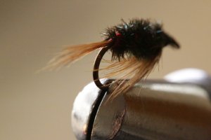

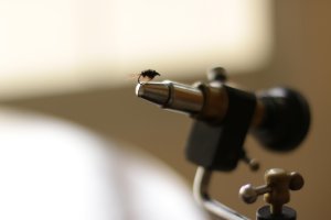

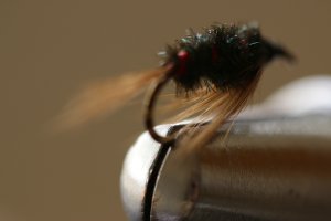

I have been interested in this post as I have just bought a new 5DIII which now accompanies my trusty 70D.
Today I did a little comparison test between the two, sorry that the test subject material is poor, but I was pushed for time and it’s summer in Dubai so going outside is pretty much off limits.
I shot the subject with both the 50mm f1.4 USM and 100mm f2.8 USM and the first thing I noticed was that the minimum focus distance remained as claimed between both model; 31cm for the 100mm and 45cm for the 50mm. This distance is the distance between the sensor locations to the subject, as seen in the first two photos below (of the 50mm lens).
The 3rd and 4th photos are the 50mm f1.4 at minimum focal distance; they’re labelled accordingly with the settings.

What do you think? If you go looking for it, there's a little more noise with the 70D, but I'm surprised how well it stands up at ISO 12,800. Probably early days with the new camera, but are you noticing a big improvement in image quality with the 5Diii, or are the differences not as big as you might have expected?

I’ve always been highly impressed with the high ISO capabilities with my 70D. I shot a Karting event at night on the day of purchase and found all the images usable even although I was at 6400 ISO. The 70D is still a far more capable camera than I am photographer, but I’m GAS mad at the moment ;D
It is still early days with the 5DIII, but the fact that the AF works with my 100-400L + 1.4xTCIII combo on it makes it instantly worth the money. Time will tell how well it performs in my hands........or should that actually be the other way around!!!!!!!!!! :o

You are showing well what I'm seeing in my 7DII compared to my 5DII - the image quality is much closer than the old 'crop vs FF' debate would lead you to believe.
The very latest crop sensors have come a long way (baby!) from where they were, and have closed the gap between Crop and FF, IMHO.
