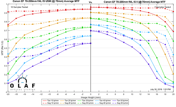

At 70mm, it’s clear that the new EF 70-200mm f/4L IS II outperforms the previous version. As you can see from the MTF below, from the center of the frame to about 2/3 of the way out, the difference will be very noticeable.

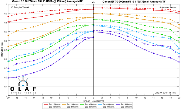

At 135mm, the previous version was better than it was at 70mm, but the new version is still showing how much better it is.

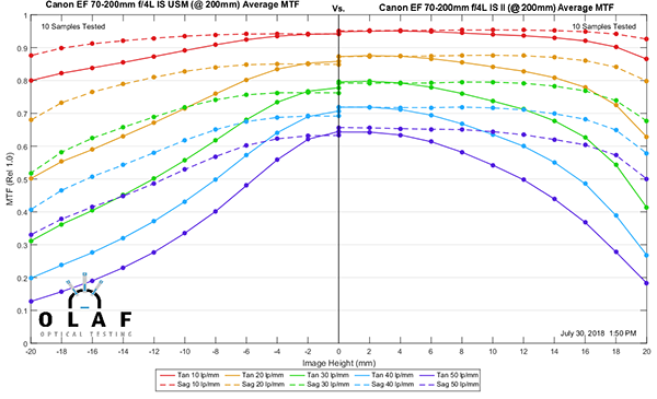

At 200mm, the focal length a lot of people buy these lenses for, the newer version shows a noticeably upgrade away from the center of the frame. At the center, the EF 70-200mm f/4L IS and EF 70-200mm f/4L IS II are pretty close to one another.
