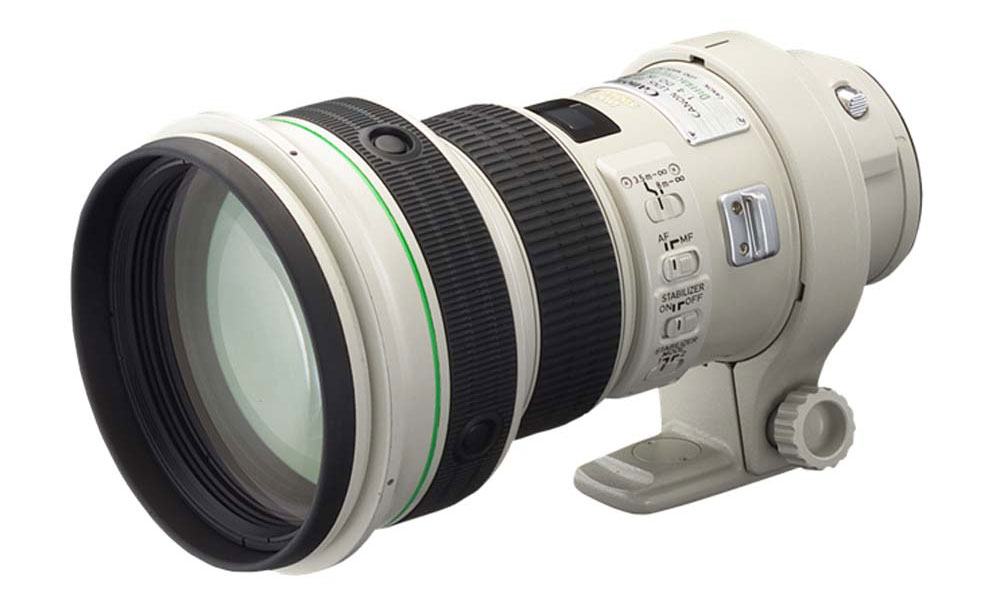

A few patents in regards to diffractive optics have come about. 70-300 f/4.5-5.6 DO IS, 14 f/2.8 DO and a 600 f/4 DO IS.
Diffractive optic patents keep coming up, though no new products are being announced. It does appear Canon is invested in the technology and thinks there is a market for it. I am a big fan of the 400 DO and hope to see longer DO lenses in the future.
Read more about the patents after the break.
