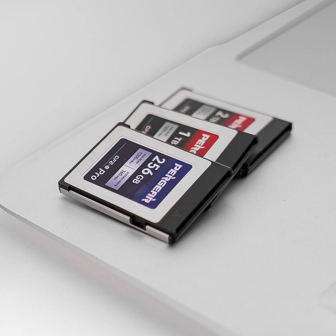

Pergear has launched new CFexpress Type-B memory cards. Pergear has priced all of these new cards quite aggressively. We have been using Pergear cards exclusively for about a year now and we have never had a problem.
Pergear has top-notch support if you do run into issues. All of their cards come with a full 5-year warranty.
Add $20 to the prices of the memory cards at Amazon, as the current stock comes with a CFexpress card reader.
Pergear 1TB & 2TB CFexpress card highlights
  1. The read/write speed has been greatly improved in stable write performance. The sustained write speed of the new PERGEAR 1T/2T card reaches 1300mb/s, which is 3.5 times compared to the elder PERGEAR generation 400mb/s.
  2. The price of the new 1T/2T CFE-B card is lower than most CFE-B cards on the market.
  3. The read/write data is not falsely advertised. We tested the card internally for
  4. 5-year warranty promise.

Pergear Lite CFE-B Performance:
Pergear Pro CFE-B Performance:
Pergear Ultra CFE-B Performance:
  • Read: 1600MB/s
  • Write: 1300MB/s
  • Highest capacity available for large file production
  • Highest bit-rate video recording and continuous mode
  • Pergear CFE-B Ultra 1TB $399 Pergear Direct | Amazon
  • Pergear CFE-B Ultra 2TB $599 Pergear Direct | Amazon
